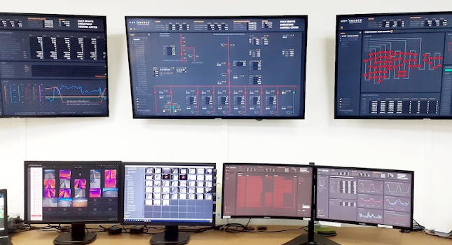

In 2018, NovaSource Chile faced the challenge of creating the Chilean Remote Operation Control Center (CROCC), located in La Serena, Chile (see Figure 2). The control center was conceived to cover the business needs NovaSource managed and maintained in the country.

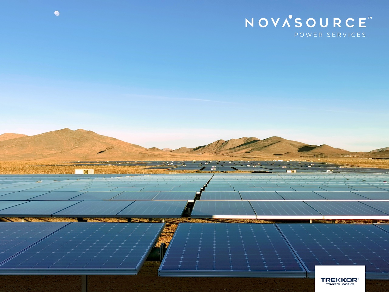

Taking advantage of the new control center project, the project scope also included the migration of old supervisory control and data acquisition (SCADA) systems (see Figure 3), existing in a few plants, which due to their lack of robustness meant inherent cyber risks linked to outdated technologies and high maintenance operational costs were preventing NovaSource from managing these assets.

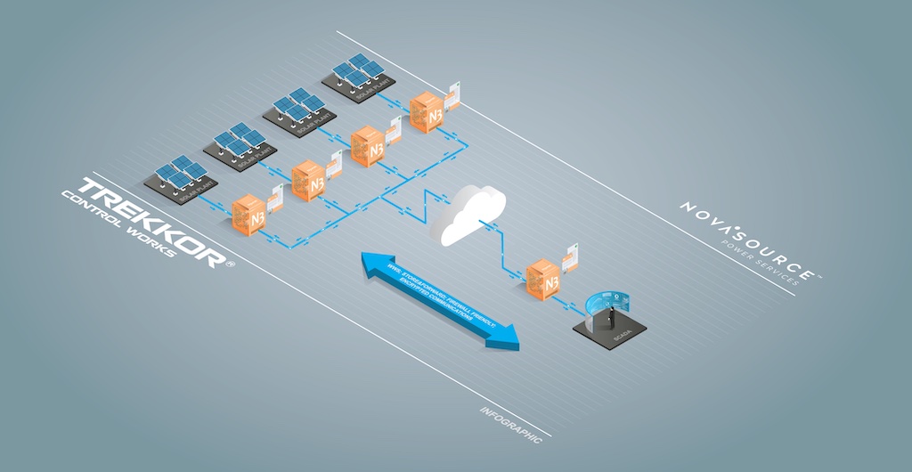

Robust and secure
To meet project requirements, Trekkor implemented N3uron, a web-based industrial application platform with integrated tools for building solutions in human-machine interface (HMI), SCADA and IIoT solutions, a software it has used for more than five years (see Figure 4).
Trekkor designed and deployed a distributed, redundant and scalable architecture including two local nodes in every plant, each of them connected to its corresponding redundant node in the CROCC.
Given the modular nature of the software, every node runs the necessary modules according to the project requirements. Modbus and DNP3 are used to communicate with field devices such as inverters, weather stations, trackers, substations and more. Message queuing telemetry transport (MQTT) and scripting are used to exchange data with third-party applications, and derived tags are used to make calculations and data aggregation.
One of the major drawbacks of previous SCADA systems was the frequent data loss, considering a typical site has around 700 devices that amount to more than 20,000 input/output (I/O) tags per site, which is a lot of data. The impact on the management of the power plants was considerable. This issue was overcome thanks to the built-in store and forward mechanism the communication between nodes provides. This means any data, either real time or historical, which is not delivered due to a communication failure between the nodes, is stored locally and automatically sent once the connection is restored.
Figure 2: At the Chilean Remote Operation Control Center (CROCC), located in La Serena, Chile. Courtesy: Trekkor
Another major advantage of the communication between nodes, called links, is data integrity and security are provided since the connection is initiated by the local node, which is configured as an outbound connection. This entails that it is not necessary to allow any inbound port in the firewall, thus preventing critical infrastructures from being exposed to cyber attacks.
On the other hand, all data exchanges between nodes are secured using the transport layer security (TLS) protocol. To enable communication, nodes must exchange digital certificates with each other that must be previously validated manually in the nodes with which they are intending to communicate. Regardless of what node starts the communication, bidirectional data exchange is possible, if it is enabled when configuring the link.
An extra security layer consisting of creating security zones also was implemented so clients in each zone can exclusively access the necessary data. To create this zone separation, depending on the information to be accessed, the software allows configuring groups of variables called views, in addition to, the read/write permissions for each variable. This enables any potentially dangerous actions to be blocked, regardless of whether it’s malicious or accidental.
The system also makes use of the TLS protocol to ensure secure and confidential communications over unsecured networks. Apart from preventing malicious third-party access to data, this measure also protects against the known vulnerability to session hijacking, which involves exploiting a valid session to gain unauthorized access to information or services.

Figure 3: The scope of the project also included the migration of old supervisory control and data acquisition (SCADA) systems. Courtesy: Trekkor

Figure 4: Trekkor implemented N3uron, a web-based industrial application platform with integrated tools for building solutions in human-machine interface (HMI), SCADA and IIoT solutions. Courtesy: Trekkor
