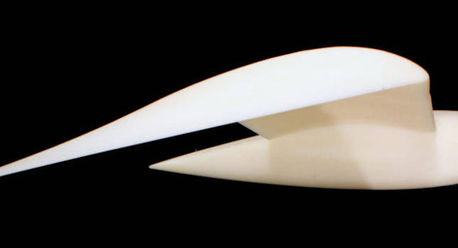

The team used computer simulations to look for the advantages of 3D morphing wings. Their studies ran through all the shapes that gulls are known to make with their wings while gliding, through combinations of “elbow” and “wrist” positions. They tested each in gliding flight simulations and identified two maneuvers in which full 3D wing morphing might be handy for UAVs. They confirmed the accuracy of the simulations with wind tunnel tests of 3D-printed models.
