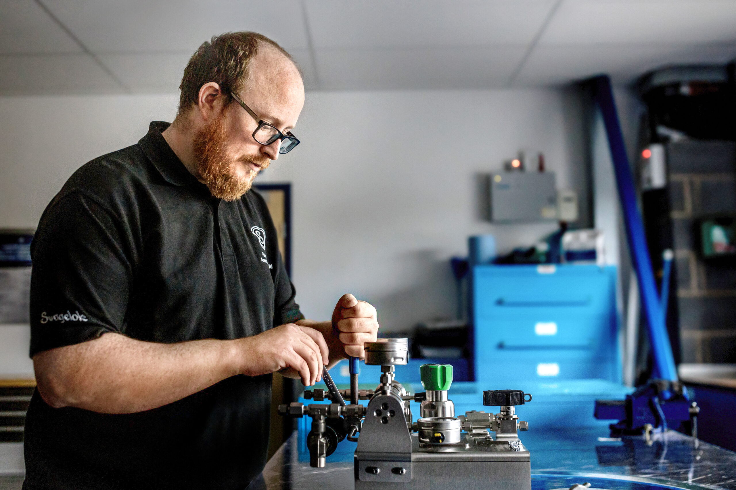

Figure 1: A gap inspection tool is crucial to ensuring fittings are tightened to proper protocols to prevent leaks. Courtesy: Swagelok Co.
Often when fluid system components fail prematurely, the cause can be linked to improper installation, especially of valves. Proper valve assembly within a system is critical to ongoing reliability. When installed correctly by properly trained technicians, valves and other components should require minimal ongoing maintenance over their life cycles.

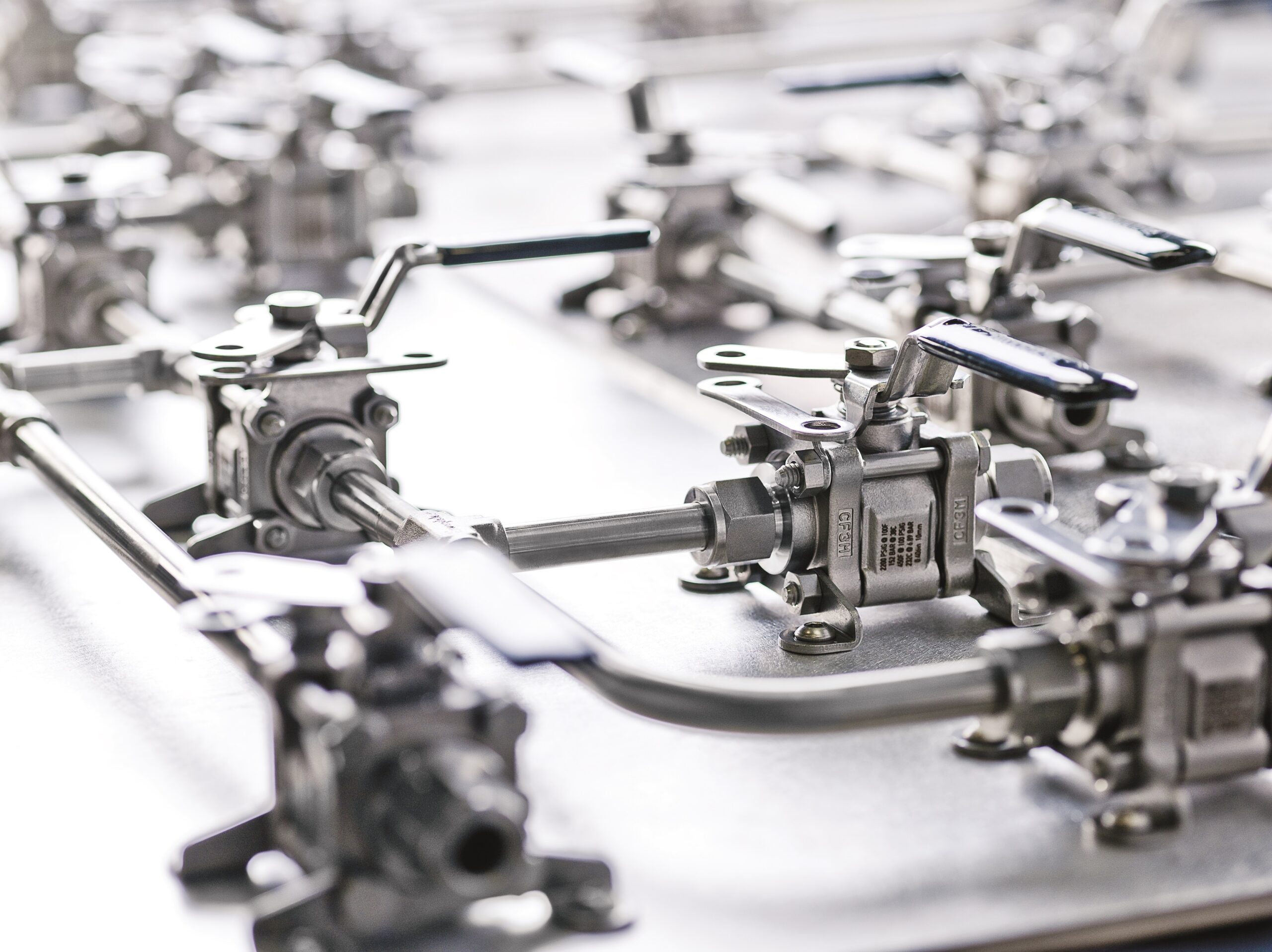

  • Provide maintenance technicians with ample space to complete their work. With the hands-on nature of maintenance and repair activity, ensuring easy accessibility is crucial (see Figure 2).
    Figure 2: System components requiring frequent maintenance should be easily accessible for technicians. Design systems so components are not obstructed by stray tubing. Courtesy: Swagelok Co.

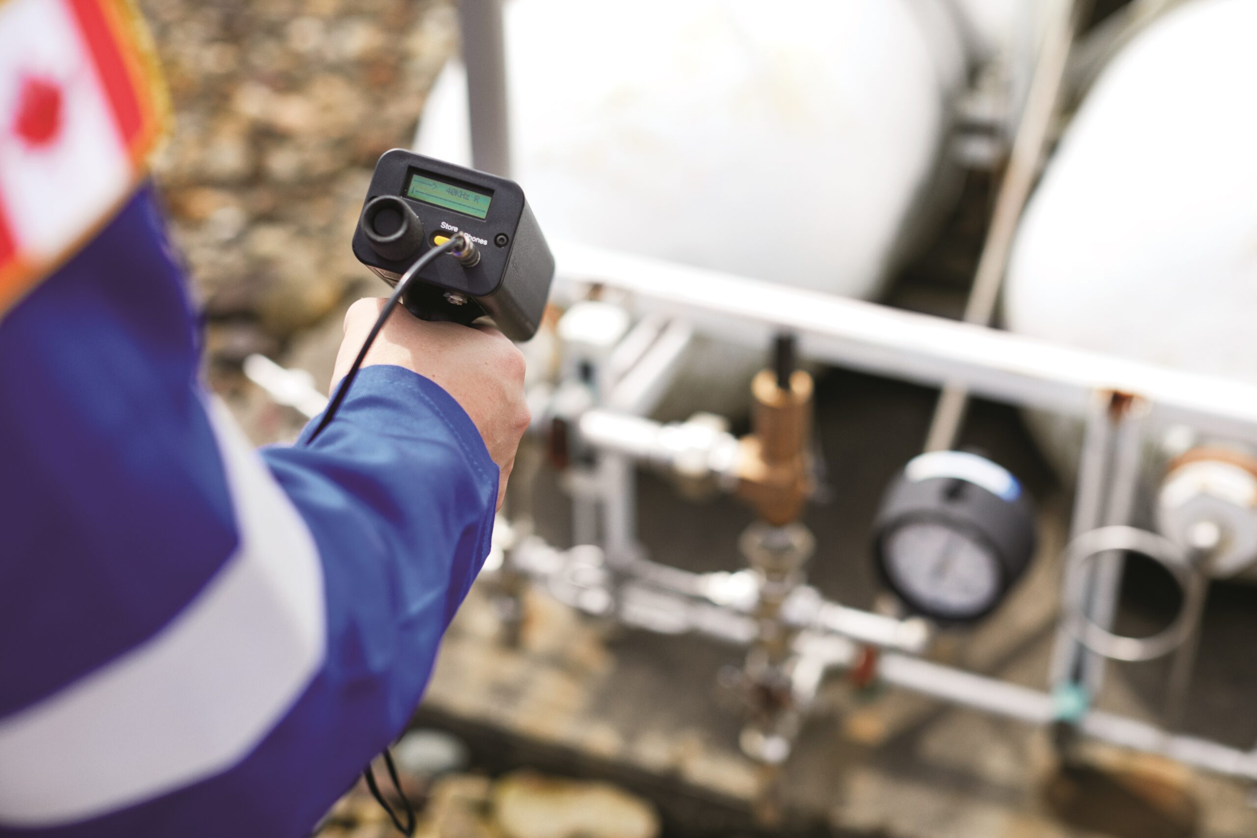

Figure 4: Ultrasonic testing equipment can detect leaks that may not be noticeable with human senses. Courtesy: Swagelok Co.
Industrial fluid systems are like fingerprints in that no two are exactly alike. Thus, the preventive maintenance schedule for one system may be radically different from the plan for another. Different factors could affect component longevity, including pressure, temperature, the fluid it carries and how many times it cycles on and off over time. It may be beneficial to consult the component supplier for its suggestions on any preventive maintenance guidelines.
In the case of overall component health, system parameters are less important. Preventive maintenance schedules should be designed to keep systems operating leak-free. Technicians may be able to detect leaks on their own by using their senses of sight and smell, but just because they do not notice anything concrete does not mean the system is free of leaks. To ensure a leak-tight system, technicians may have to deploy ultrasonic leak-detection equipment (see Figure 4) or liquid leak detectors (see Figure 5). It is important to catch leaks as early as possible to prevent them from becoming more dangerous over time.

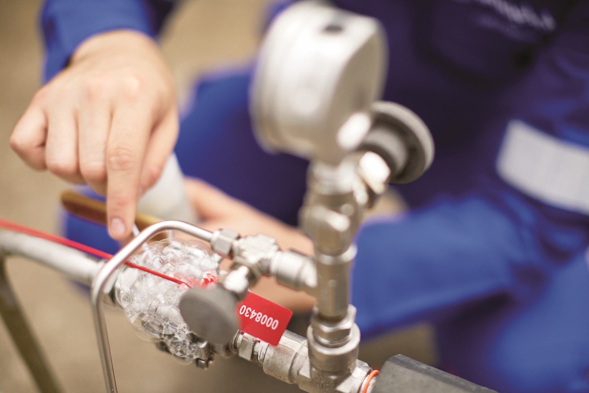

Figure 5: Bubble testing is an effective way for technicians to test for leaks and determine if fitting connections must be tightened or replaced. Courtesy: Swagelok Co.
Minimally, effective tags should have the part number, date of manufacture and trace identification order on them, allowing for easy ordering of new parts as necessary. Ideally, the tag would also contain information on the system media, operating pressures and temperatures. The type of tag used and the information included are unique to each situation and may be supplied by the component vendor.
