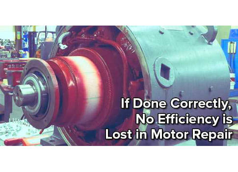

In many businesses, electric motors are representative of a substantial capital investment. They also result in some of the highest costs for the ongoing operation of the business. At times, the company may end up paying ten times as much in energy as they do for the initial cost of the motor. The motor’s efficiency is a key aspect during the repair process and should be a major consideration.
Having a well thought out preventive maintenance program at the facility is one way to contribute to reducing problems with electric motors. Like any piece of equipment, however, motors will eventually break down, and repairs will need to be made. A motor rewind is common electrical motor repairs and can provide many benefits for users.
It is commonly believed that rewinds cause a motor to lose efficiency, but that is an outdated understanding. When the proper materials and methods are used for rewinding, it will not have a significant impact on the reliability or the efficiency of the motor. In fact, it might improve both the power and the reliability associated with an electric motor when the rewind is performed by a trained and qualified service provider.
