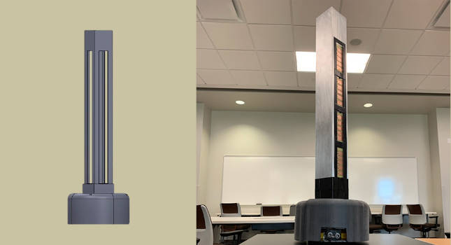

The team built a low-cost, small-footprint ultraviolet (UV) robot. The robot autonomously travels through a room and emits UV light onto surfaces. UV light is a type of radiation and has been proven to kill germs like bacteria and viruses successfully. The team aimed to find a solution that was more efficient and safer than chemicals or other disinfectants.

The design involves a flat base with a tower about three feet tall made out of an aluminum shell to help dissipate heat from the LEDs, which will be seated on top of the tower. By having the device be tall, the lights will reach above desks and hit different areas.
