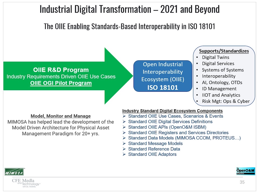

- The Open Industrial Interoperability Ecosystem (OIIE) is the first specification for a supplier/vendor neutral industrial digital ecosystem that enables standards-based interoperability for applications and systems across the full asset lifecycle.
- The OIIE and the associated OIIE OGI Pilot provides the basis for ISO 18101, which is the 1st ISO or IEC standard for a supplier/vendor-neutral industrial digital ecosystem.
- The OIIE and ISO 18101 interoperability approach is included in ISO/IEC JWG 21 TF 8 work on digital ecosystems and digital twins for Smart Manufacturing.

“The Open Industrial Interoperability Ecosystem (OIIE) is the first specification for a supplier/vendor neutral industrial digital ecosystem that enables standards-based interoperability for applications and systems across the full asset lifecycle. It is being developed, validated and updated through the OIIE Oil and Gas Interoperability Pilot, which is managed by MIMOSA in cooperation with other industry associations. Outputs from this pilot are used to generate formal ISO Technical Reports as the input for future parts of ISO 18101 which addresses interoperability for asset intensive industries,” Johnston said. “This approach has also now led to the results being included in ISO/IEC JWG 21 TF 8 work on digital ecosystems and digital twins for Smart Manufacturing.”
