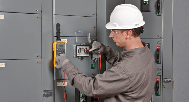

For example, qualified maintenance personnel performing mechanical LO/TO are tasked with isolating electrical energy. As part of the verification of de-energized condition, OSHA requires a person to operate the equipment controls, also known as a try/test, to ensure the equipment cannot be restarted. There are several significant risks associated with solely relying on the try/test. These risks often include isolating the wrong controls, accidental restart of the equipment, getting caught in the equipment or contact with live source of energy at the machine level.
Safety conscious and forward-thinking companies understood these risks early on and started to require electricians to perform absence of voltage testing for mechanical LO/TO. With the advent of NFPA 70E: Standard for Electrical Safety in the Workplace and research on arc flash, employers began to realize through job hazard analysis that this task, while reducing the hazards of the energized condition of the equipment, greatly increased the exposure to electricity in performing the test itself. Additionally, the involvement of an electrician in a simple mechanical LO/TO further hampered productivity.
A safety-by-design solution was found for this scenario in an externally mounted LED voltage presence indicator. This provides an alternative means to verify the voltage presence inside an electrical panel while safely unexposed from the outside in addition to the OSHA required try/test. Without a voltage indicator, a mechanic performing mechanical LO/TO would be required to work in tandem with an electrician using a voltmeter to physically verify voltage inside an electrical panel (see Figure 1). In this case, the electrician is exposed to voltage. With the combination of the try/test and through-door LED voltage presence indicators, the mechanic can solely verify when the panel is in an energized condition without any voltage exposure.
