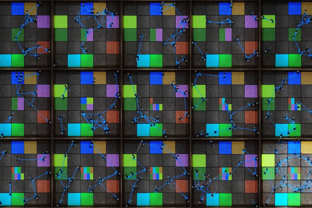

In this simulation-based study, the information stored in each block is a set of directions from a leader robot to followers. If a malicious robot attempts to alter the content of a block, it will change the block hash, so the altered block will no longer be connected to the chain. The altered directions could be easily ignored by follower robots.
The blockchain also provides a permanent record of all transactions. Since all followers can eventually see all the directions issued by leader robots, they can see if they have been misled.
For instance, if five leaders send messages telling followers to move north, and one leader sends a message telling followers to move west, the followers could ignore that inconsistent direction. Even if a follower robot did move west by mistake, the misled robot would eventually realize the error when it compares its moves to the transactions stored in the blockchain.

The researchers tested their system by simulating several follow-the-leader situations where the number of malicious robots was known or unknown. Using a blockchain, leaders sent directions to follower robots that moved across a Cartesian plane, while malicious leaders broadcast incorrect directions or attempted to block the path of follower robots.
The researchers found that, even when follower robots were initially misled by malicious leaders, the transaction-based system enabled all followers to eventually reach their destination. And because each leader has an equal, finite number of tokens, the researchers developed algorithms to determine the maximum number of lies a malicious robot can tell.
