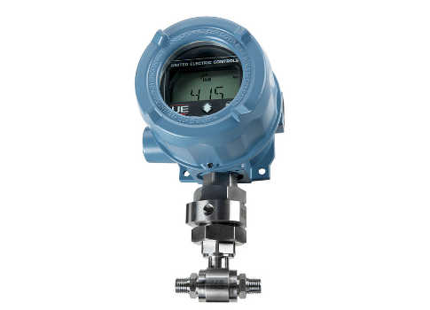

One Series 1X line of explosion-proof, programmable transmitters and switches provide unique alternatives to both conventional mechanical switches and transmitters for controlling operations.
One Series 1X line of explosion-proof, programmable transmitters and switches provide unique alternatives to both conventional mechanical switches and transmitters for controlling operations such as pumps and compressors, lubrication oil monitoring, hydraulic pressure, filter status and other industrial applications based on temperature or pressure. All One Series models have extensive diagnostics, programmability and trip management capabilities. Configurable I Am Working (IAWâ„¢) self-diagnostics provide piece of mind that the instrument is functioning properly by communicating with the control system using a dedicated discrete fail-safe-open output. The integral digital process display shows what is happening in the process at a glance. Powerful plugged port diagnostics flag potentially dangerous sensor clogs and memorizes the highest and lowest process variables for process troubleshooting and learning.
