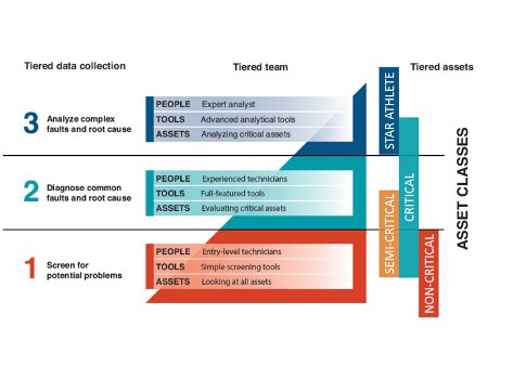

However, these approaches end up being inflexible, unsustainable and miss the root cause of the dilemma of criticality: organizations have more assets than the maintenance team has capacity to manage. The first step to decreasing the impact of the criticality dilemma is to establish better classification. Consider these four classifications for assets (Fig. 1):
- Star athletes: The percent of production or compliance is correlated directly with this asset’s performance. It needs constant assessment and optimization regardless of condition, and always must be running at peak performance levels.
- Critical: The performance level of this asset is not as important as simply "running or not running," but the uptime of this asset is correlated to producing revenue.
- Semi-critical: Downtime or failure of this asset puts a strain on production or compliance. Daily processes may be able to continue sub-optimally even if the asset fails.
- Non-critical: Production or compliance are not affected by this asset. While there may be other reasons to fix this asset, it is not because of direct production loss.

This tiered operating approach can be applied to the maintenance world. With a tiered maintenance program, organizations waste less time analyzing healthy machines, reduce the number of work orders flowing through an organization and avoid deploying experts on simple faults. Here is an example of tiered maintenance (Fig. 2):
