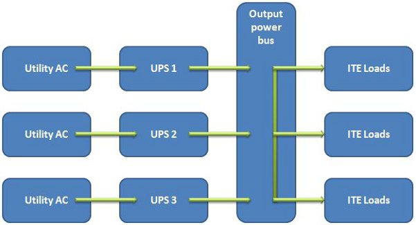

Deploy paralleled UPSs
The logic of redundancy applies as much to power protection schemes as it does to uninterruptible power systems (UPSs) designs (Figures 1 and 2). Building multiple power paths into a power design inherently increases reliability.
Figure 1 illustrates two simple but important points: Power path components that are serially connected, like Subsystems A, C, and D, weaken overall reliability. Power path components that are parallel redundant, like Subsystem B, improve overall availability. That is because a failure in Subsystems A, C, or D could take down the entire power path. Subsystem B, by contrast, has three parallel components. If one of them goes offline, the others compensate for it, keeping the system as a whole functioning.
