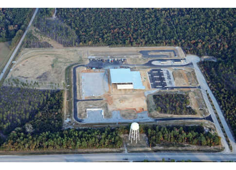

Should you renovate your existing facility or build a new facility? This question isn’t an easy one to answer and is, of course, dependent on capital expenditure. However, your answer should also be driven by your company’s strategic plan to ensure that your decision aligns with your long-term needs and goals.

If your existing facility is already somewhat similar to what the desired, renovated end state will be, renovation is probably your best option. However, modifications that require gutting the original facility may call for building a new plant.

Deciding whether to renovate an existing facility or build a new one is not easy. Weigh the pros and cons of both to determine the better fit for your food manufacturing facility’s long-term goals.
