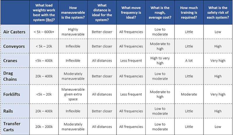

Seven factors to consider when choosing a load movement system.
Seven factors to consider when choosing a load movement system. Courtesy: AeroGo

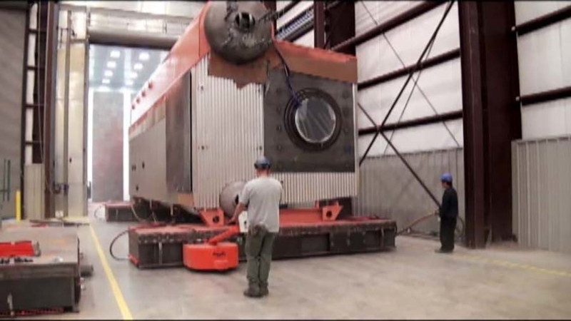

A 100-ton boiler is driven through a plant door using a power drive and air casters.
A 100-ton boiler is driven through a plant door using a power drive and air casters. Courtesy: AeroGo

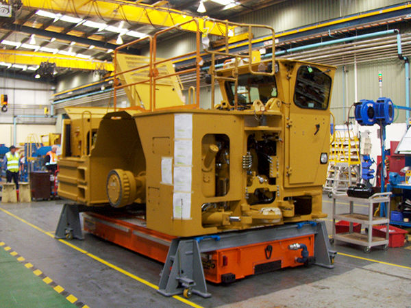

Short moves in a flexible assembly line benefit from an untethered load movement option, such as an air cushion vehicle. Courtesy: AeroGo

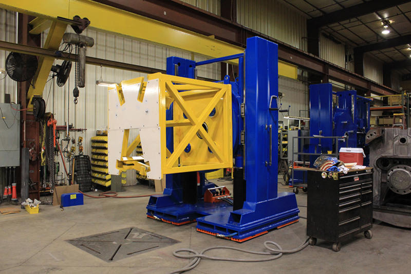

Two material handling options work in tandem here: an embedded air caster system moves a rebuild engine positioner below a crane.
Two material handling options work in tandem here: an embedded air caster system moves a rebuild engine positioner below a crane. Courtesy: AeroGo

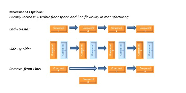

Maneuverability: By this point, companies should have narrowed the list of potential material handling solutions significantly, eliminating any system that cannot feasibly bear the weight or fit within the logistical constraints of the production or manufacturing process. From here, the facility itself can present another challenge in that it could impose significant difficulties that affect the choice of load movement system.
The shape, layout and configuration of the facility and the equipment it contains will make certain material handling systems more or less viable than others. The load path, for example, may need to vary or eventually be reconfigured while a permanent installation such as rails and cranes will limit reconfigurability. On the other hand, if the load always follows the same path, a permanent installation like a conveyor system will likely operate more efficiently with faster production times and lower costs over the lifetime of the equipment.
Should the picture change and management decide to reconfigure the entire assembly line to add stations, build different products or increase overall production, a permanent solution is out of the question. There is also the possibility that a product may need to be set aside e.g., a vehicle under construction that requires an extra part not immediately available may need to be temporarily parked outside the manufacturing line.
