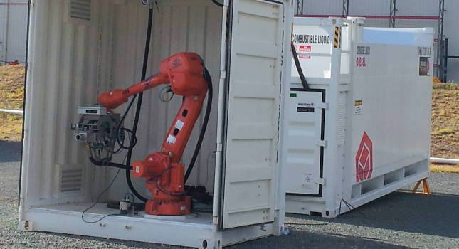

The Robofuel system consists of a self-contained industrial robot with a custom end effector, sophisticated sensing systems and proprietary software designed to enable autonomous refueling of massive mining trucks. The mining space provides a structured environment in which to launch and fine-tune this technology, but SCOTT sees broader potential.

Robofuel can be retrofitted to an existing fixed refueling facility, or it can be located on the mining circuit or in the pit itself to save transit time between refuels. The system can also be moved around as mining operations evolve.
The entire system is assembled in the shipping container at the factory. Then it’s ready to deploy and redeploy as needed. The door on the container automatically closes in between refueling activities, so the robot and its control systems, which occupy the back-half of the container, are protected from the elements. Russell said they chose an articulated industrial robot for its flexibility to be able to locate and align to the vehicle.
A long-range RFID reader detects a vehicle as it approaches. Laser scanning systems evaluate the local area and are part of the safety perimeter system. Exclusive to SCOTT, the vision-based primary sensing systems assist the robot in locating and removing the fuel cap, inserting the fuel nozzle, and reattaching the cap when refueling is complete.
Robofuel is fully autonomous and doesn’t require any direction from the vehicle driver. In the case of autonomous haulage systems, Robofuel communicates directly with the vehicle. There’s no requirement for remote control.
