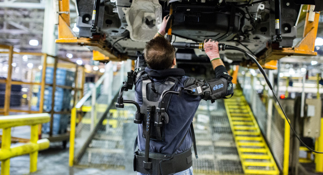

Wang, who serves as the project’s principal investigator, says there are a few exoskeleton products currently available on the market, but they mainly target the industrial/manufacturing setting. The exoskeleton is still a new concept in construction because the construction site is more dynamic and complicated.
“We’re seeing how we can explore personalized exoskeleton or robotics technology,” said Chao Wang, an assistant professor at LSU. “In a manufacturing facility, a worker probably does the same thing 1,000 times a day. It’s repetitive, which is perfect for an exoskeleton because they design it just for that one task. A construction site is a lot different. You must be able to climb stairs, walk, squat, and reach out to different levels depending on what trade you are in.
“That makes it difficult to design an exoskeleton because you need something that can help with all of these tasks. We are investigating how to make the exoskeleton smart enough to recognize what task the construction worker is doing and adjust its power level and control strategy to more effectively assist with the work.”
The researchers will study what tasks each construction crew member performs in order to develop and train an exoskeleton that fits different construction tasks. They will consider if the robotic exoskeleton should support the upper or lower body and how much power should be given.
“In medical and military applications, you wear a lower limb exoskeleton to prevent you from falling while giving support from the bottom,” Wang said. “However, on a construction site, when you frequently kneel or squat, you will have a lot of resistance from the exoskeleton if the power level and control strategy is not properly set. The robot must be smart enough to know what you’re trying to do and what your next move is, so it must be adjusted accordingly.”
