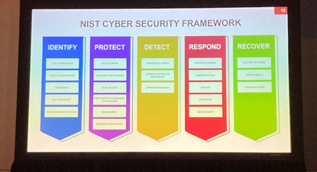

Which framework to pick comes down to your objective and what your regulatory requirements are. Different frameworks are better for different things. You obviously need to know which systems the framework or regulations cover. According to a 2017 study by the SANS Institute, the NIST Cybersecurity Framework (identify, protect, detect, respond, recover) is becoming a leading framework in industrial environments.
