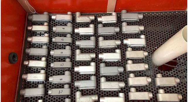

To determine the corrosion resistance of various protection methods used on conduit bodies, Emerson turned to Intertek, an independent total quality assurance provider to industries worldwide with more than 1,000 laboratories and 44,000 employees. Intertek conducted ASTM B117-18: Standard Practice for Operating Salt Spray (Fog) Apparatus performance testing on iron conduit bodies from three major manufacturers. A total of 39 conduit bodies were tested, all in the 3/4-inch trade size (see Figure 1).
The salt solution used was 5% ±1% according to ASTM B117-18. To prevent salt fog from entering the interior of the conduit body, all iron test samples had steel (zinc plated) plugs installed, with aluminum plugs with Teflon tape in the aluminum samples. Test samples were subjected to the salt fog for 1,008 hours (42 days), being removed only for inspection and photography at fixed intervals.
Testing was conducted in the Arlington Heights, Ill. Intertek laboratory in January 2019. Test samples were sorted into 15 groups according to metal and protection types, i.e., malleable iron (plated/painted), die-cast aluminum (painted), cast iron (plated/painted), cast aluminum (unpainted) and so on. All samples were purchased at electrical distributors from their inventory and not sourced from the manufacturer. This article examines the results of the malleable iron and cast-iron samples.
