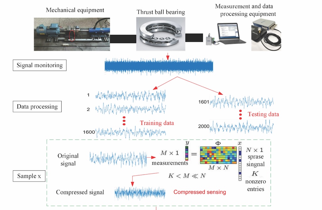

Figure 1: Onboard sensors signal unusual vibration patterns that can indicate when a bearing is beginning to fail.

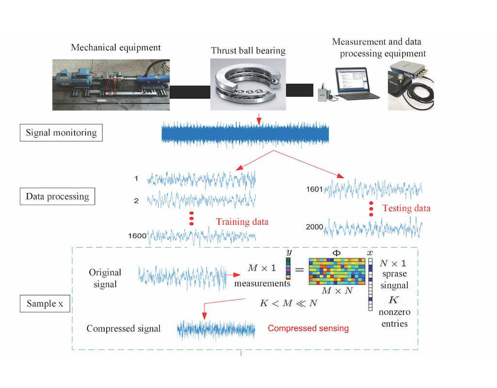

Figure 1: Onboard sensors signal unusual vibration patterns that can indicate when a bearing is beginning to fail. Courtesy: Jinyi Tai, J., et al. (June 2022), “Mathematical biosciences and engineering: MBE,” 19 (8), pp. 8057-8080, CC BY 4.0./STLE

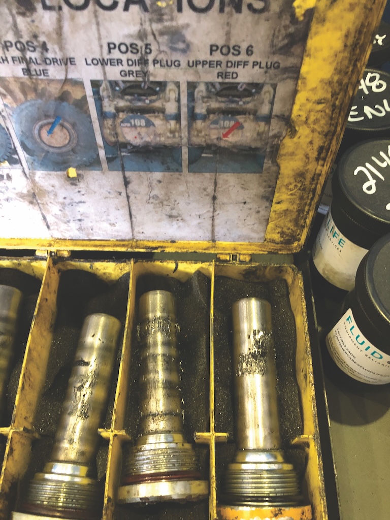

Figure 2: Magnetic plugs in the oil stream of heavy, off-road vehicles capture magnetic debris for laboratory analysis.
