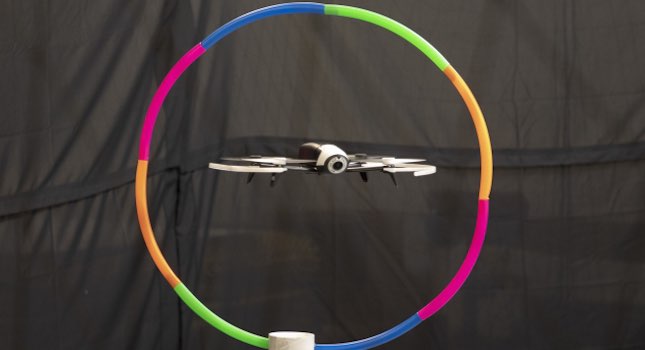

While Conduct-A-Bot could potentially be used for various scenarios, including navigating menus on electronic devices or supervising autonomous robots, for this research the team used a Parrot Bebop 2 drone, although any commercial drone could be used.
By detecting actions like rotational gestures, clenched fists, tensed arms, and activated forearms, Conduct-A-Bot can move the drone left, right, up, down, and forward, as well as allow it to rotate and stop.
If you gestured toward the right to your friend, they could likely interpret that they should move in that direction. Similarly, if you waved your hand to the left, for example, the drone would follow suit and make a left turn.
In tests, the drone correctly responded to 82% of over 1,500 human gestures when it was remotely controlled to fly through hoops. The system also correctly identified approximately 94% of cued gestures when the drone was not being controlled.
