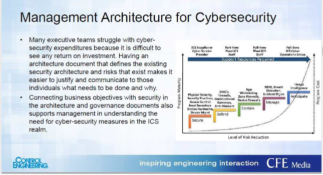

Question: How do you sell the cybersecurity investment to executive stakeholders to achieve buy-in? How should systems integrators build cybersecurity into their services offerings to help protect the end user (clients)?
Bonnette: Conduct a risk assessment that puts the risk of a cyber compromise into context as a business and physical facility risk. Reference ANSI-ISA 62443-2-4-2018 Security program requirements for IACS service providers – framework for an owner and Control System provider / integrator to come to mutual agreement as to the scope of cybersecurity measures the provider will employ and ensure as part of a provided service (design/build/configure/test/deliver).
