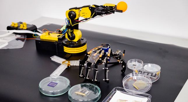

The approach embeds AI into the network of sensor nodes, connected to multiple small, less-powerful, processing units, that act like ‘mini-brains’ distributed on the robotic skin. This means learning happens locally and the wiring requirements and response time for the robot are reduced five to ten times compared to conventional robots, say the scientists.
Combining the system with a type of self-healing ion gel material means that the robots, when damaged, can recover their mechanical functions without human intervention.

To teach the robot how to recognize pain and learn damaging stimuli, the research team fashioned memtransistors, which are ‘brain-like’ electronic devices capable of memory and information processing, as artificial pain receptors and synapses.
Through lab experiments, the research team demonstrated how the robot was able to learn to respond to injury in real time. They also showed that the robot continued to respond to pressure even after damage, proving the robustness of the system.
When “injured” with a cut from a sharp object, the robot quickly loses mechanical function. But the molecules in the self-healing ion gel begin to interact, causing the robot to ‘stitch’ its ‘wound’ together and to restore its function while maintaining high responsiveness.
