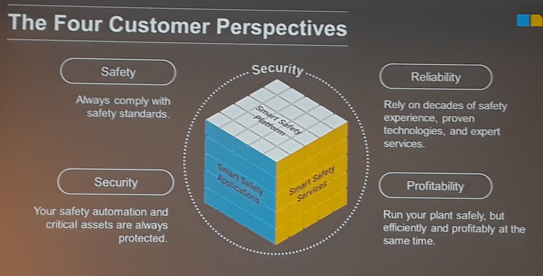

Smarter safety with cybersecurity: Hima
Dr. Alexander Horch, vice president of R&D and product development for Hima, explained the importance of integrating scalable safety with cybersecurity with hardware and software, including firmware and communications. Such integration reduces complexity so operators can buy and use only what’s needed. This helps lower costs in one application with more than 60% savings in engineering and testing.
Such changes can be achieved while leaving cabling and input/output level unchanged, with less engineering. Stronger encryption of communications between controllers is under consideration as part of IEC 61784-3, edition 4, Horch said. Hima’s partnership with genua, (a cybersecurity firm purchased recently by the German treasury) is helping develop communications and kernels with less risk.
