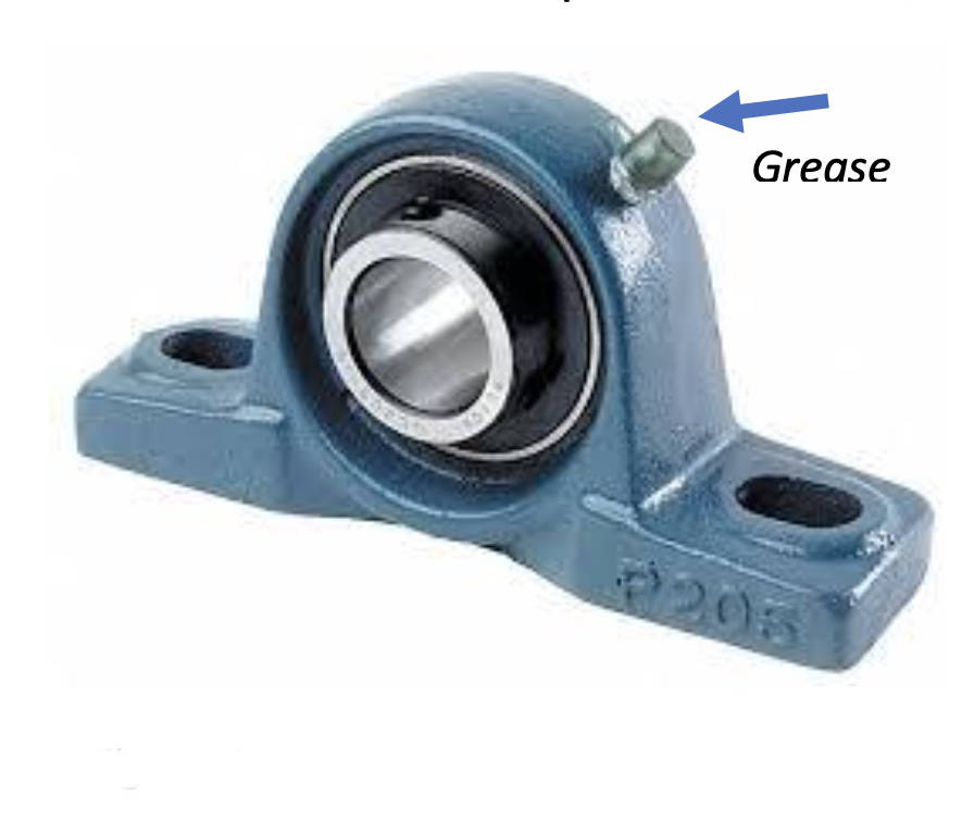

Bearings and bushings allow shafts to rotate or slide smoothly. Bearings often have some type of rollers or balls that require lubrication, there will be a fitting on the outside of the bearing housing if so. Grease or other lubricants are applied periodically using a grease gun, or it may be done automatically. Bushings may also contain balls or rollers, but typically do not have grease fittings. They are often just softer metal collars that a shaft can rotate or slide smoothly in. As bearings or bushings wear, they can often make noise or create heat. This is an example of using your senses to detect problems with these devices.
Figure 1: Example of a bearing. Courtesy: Automation LLC

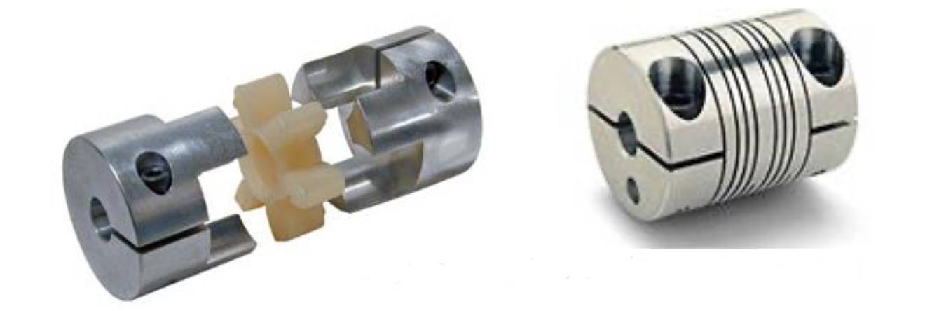

Figure 2: Spider and helical couplings. Courtesy: Automation LLC
Couplings are used to connect the shafts of motors to other devices such as gearboxes and encoders. They are meant to compensate for vibration and slight misalignments, but because they move and can be less sturdy that the shafts themselves, they create another failure point, Spider couplings are made of elastomeric materials, and helical couplings can have very delicate structures. They are also usually located inside a housing, so they can be hard to view and take time to replace.
Loose couplings also allow for positional errors in servo systems. If a motor position starts to drift, the coupling should be checked for proper tightness. Keyed couplings are often used to eliminate shaft slippage.

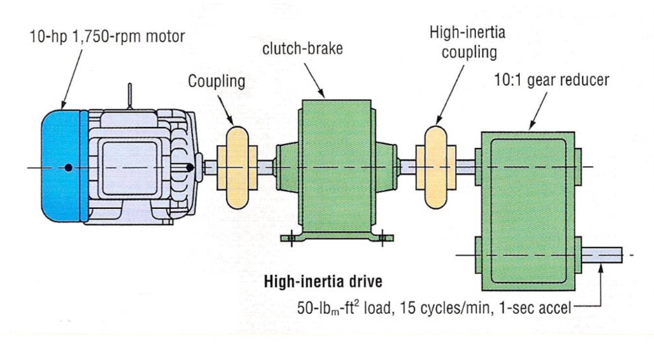

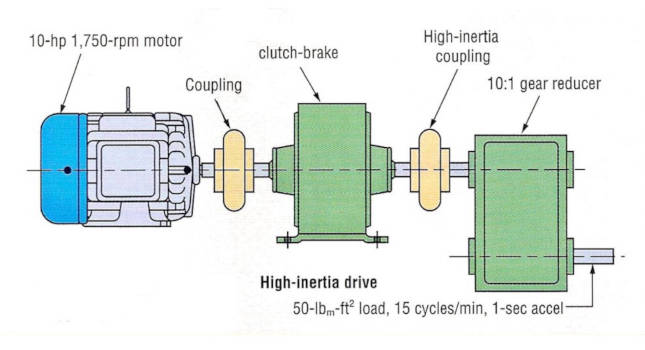

Figure 3 shows many of the elements listed in combination. This powertrain changes the output speed and torque from the driving motor and allows the load to be connected and disconnected, bringing it to a quick stop.
Figure 3: Mechanical powertrain example. Courtesy: Automation LLC
