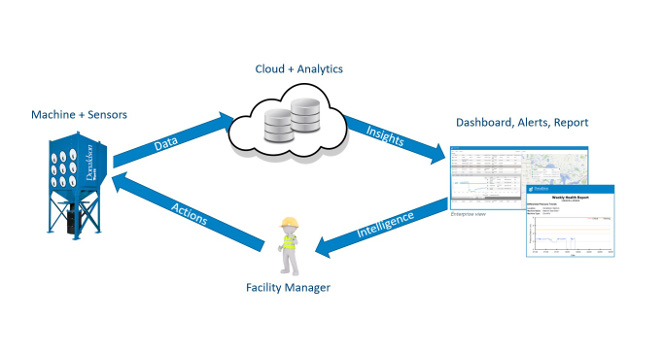

The benefits of monitoring nonproduction equipment with connectivity are becoming evident. In late 2018, Donaldson Co. introduced technology that monitors certain aspects of dust and fume collectors remotely and is launching a subscription service that provides this capability.
Using cloud connectivity, the connected solution gathers sensor data from operating equipment, applies filtration analytics and sends meaningful information back to the owner via a web-based dashboard, email alerts and weekly status reports (see Figure 2).
