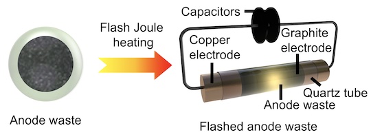

Probably more than a few, and they’re great for powering all the things important to modern lives: cellphones, watches, computers, cars and so much more. But where they go when they fail is a growing problem. Rice University scientists believe they have a partial solution that relies on the unique “flash” Joule heating process they developed to produce graphene from waste. The Rice lab of chemist James Tour has reconfigured the process to quickly regenerate graphite lithium-ion anodes materials found in lithium-ion batteries, removing impurities so they can be used again and again.
The lab’s work appears in Advanced Materials.
Flashing powdered anodes from commercial batteries recycles some of what the researchers called the “staggering” accumulation of waste they currently leave behind. In just a few seconds, a jolt of high energy decomposes inorganic salts including lithium, cobalt, nickel and manganese from an anode. These can be recovered by processing them with dilute hydrochloric acid.

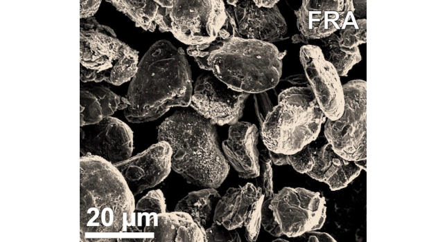

Rice chemists use flash Joule heating to recover graphite anodes from spent lithium-ion batteries at a cost of about $118 per ton. Courtesy: Rice University
Flashing then coats the remaining graphite particles with an ion-permeable carbon shell that contributes to their future capacity, rate performance and cycling stability compared to materials conventionally recycled in a time-consuming and energy-intensive process known as high-temperature calcination.
The lab estimated it would cost about $118 to recycle one ton of untreated anode waste. They demonstrated that flash-recycled anodes have a recovered specific capacity of 351 milliAmp hours per gram at 32 degrees Fahrenheit, superior to the rate performance and electrochemical stability of untreated or calcinated recycled anodes.
