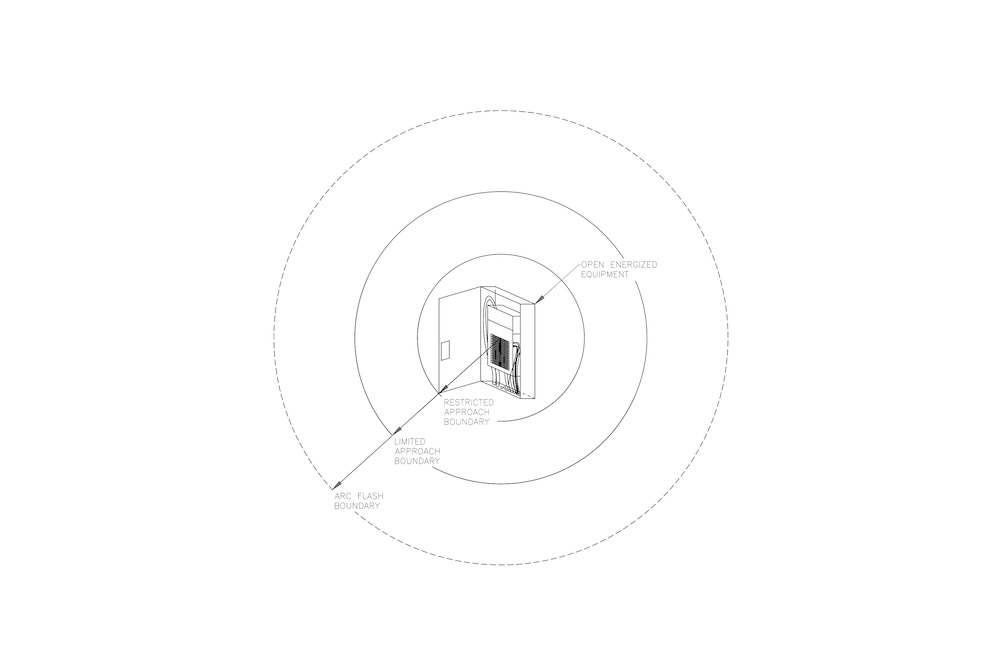

There are two electric shock protection boundaries that should be identified for each given piece of equipment: limited approach and restricted approach. These boundaries identify the distance, determined based on the voltage potential between the source and ground, from where qualified and unqualified persons, as defined by OSHA 29 and NFPA 70E, may interact with equipment where shock hazards are present.
Limited approach boundary: An unqualified person may enter this boundary under supervision of qualified persons.
Restricted approach boundary: Only qualified persons may enter this boundary with proper PPE as listed in NFPA 70E.
Arc flash: Arc flash is a release of thermal energy from an electric arc between electrical conductors or to ground. The amount of energy, or arc flash, is dependent on the fault current and clearing time. The fault current value is dependent on the utility and its equipment supply. The clearing time is the amount of time the overcurrent protective device takes to trip (open) during a fault situation. An arc flash risk assessment is conducted to identify the incident energy at the work distance (or arc flash PPE category), arc flash boundary and PPE required to protect against arc flash hazards.
Like the electric shock boundaries, although completely independent from one another, there is a single arc flash boundary required to be identified to determine the distance at which the incident energy equals 1.2 cal/cm2.
This value was determined based on the Stoll skin burn injury model, where the onset of a second-degree burn on unprotected skin is likely to occur at an exposure of 1.2 cal/ cm2 for one second. This value is deemed to be a curable burn.
When working within the arc flash boundary, proper clothing and PPE should be selected and worn for protection from arc flash hazards. Selection of proper PPE is determined based on either the incident energy method or the arc flash PPE category method as defined in NFPA 70E.
For example, when using the incident energy level method, NFPA 70E Table 130.5(G) should be used to select proper PPE based on amount of incident energy calculated for each individual equipment. When using the arc flash PPE category method, NFPA 70E Table 130.7(C)(15)(c) would be used for selecting proper PPE. Outside of this boundary, PPE is not required. However, caution should still be considered as injury can still occur even when working outside of the arc flash boundary.

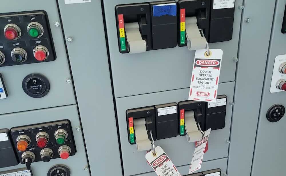

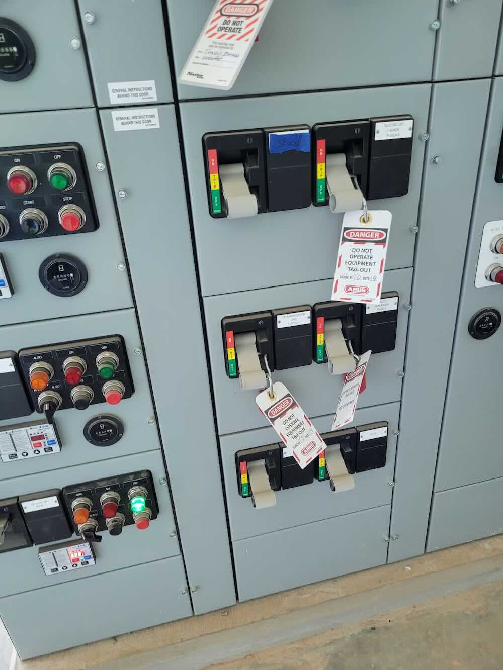

There are other important aspects to electrical safety regarding these electrical hazards, including establishing electrically safe work conditions. An electrically safe work condition as defined by NFPA 70E is “a state in which an electrical conductor or circuit part has been disconnected from energized parts, locked/tagged in accordance with established standards, tested for the absence of voltage and, if necessary, temporarily grounded for personnel protection.” Establishing this electrically safe work condition is employed to prevent injury from either direct or indirect electrical contact.
The process for establishing and verifying an electrically safe condition is based on NFPA 70E and includes eight items:
Determine all possible electrical sources.
Open disconnecting devices(s) for each source.
Visually verify that all blades of disconnecting devices are withdrawn to the test or full disconnected position.
Release stored electrical energy.
Block or relieve stored nonelectrical energy in devices.
Apply lockout/tagout devices.
Use adequately rated portable test instrument to test conductors for absence of voltage.
Where the possibility of induced voltages or stored electrical energy exists, ground all circuit conductors and circuit parts before touching them.

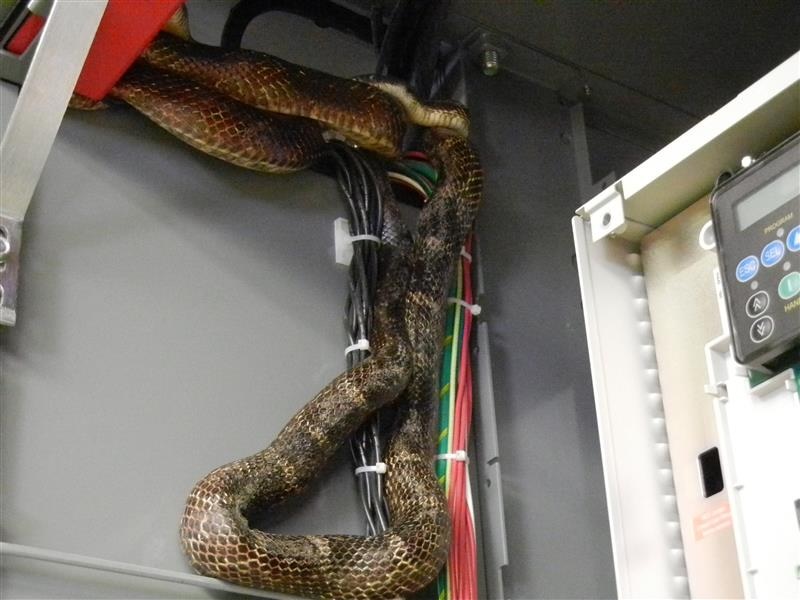

Natural hazards: Electrical workers are likely to be exposed to smaller creatures such as snakes, spiders, bees, ants and ticks. While most such creatures are harmless to humans, there are varieties that are venomous or otherwise potentially dangerous. Electrical equipment offers spiders, bees and other flying biting/stinging insects, ants and even snakes warm, sheltered locations in which to rest or build a home. Snakes, spiders or ticks may be encountered when accessing outdoor equipment in areas that have not been well maintained in places like overgrown grass or shrubbery. In general, such animals are unlikely to bother workers unless disturbed or directly confronted, so a worker may reduce their exposure simply by being aware of their surroundings and avoiding interactions.
When bitten by a spider or snake, common incorrect actions include trying to catch or handle the creature, even when dead (instead: take a picture), attempting to suck out the poison, applying tourniquets, etc. First aid for most incidents includes washing the bite with soap and water, removing rings and watches before swelling occurs and seeking immediate medical attention.
