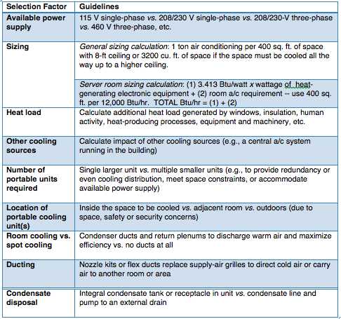

Selecting Portable Cooling Equipment
There are many things to consider when selecting portable cooling equipment. Table 1 summarizes the selection factors to review with your supplier.
Every model of portable air conditioner is designed for use with a particular type of electric circuitry. So it’s a good idea to start by looking at the available power supply, which will often dictate equipment selection.
Fortunately, with recent product advances, the choices are better than they were in the past. There are now portables on the market that will run on convenient 460-volt 3-phase power and deliver 5 tons of cooling or more, allowing a single unit to do the job where two or three used to be needed – if there is adequate floor space for the larger unit.
Sizing
Equipment sizing, defined as cooling capacity in Btu/hr or tonnage (12,000 Btu/hr = 1 ton of cooling), is also critical. A general rule of thumb is to plan on 3.413 Btu per watt when calculating equipment size. That translates to around 1 ton of air conditioning for a “typical” 400 sq. ft. room with an 8-ft ceiling and no additional loads other than lighting, or 3200 cu. ft. if the space must be cooled all the way up to a higher ceiling. From there, heat load factors unique to the application must be added into the equation.
If you are cooling a non-manufacturing space such as an office or conference room, you will need to consider:
- Does the room have windows or other openings, and what is the exposure?
- What power is available?
- What kind of equipment is in the room and how much load is being generated?
- What is the occupant level and activity within the space?
- How much cooling is already coming in via a central air handling system or other source?
- How many portable units will be needed to achieve even cooling distribution?
All of this should be considered when determining the proper a/c unit(s) for the application.
On the manufacturing floor, the same factors as above will come into play, but other things will impact equipment sizing as well. How much heat is being generated by the process? What temperature are you trying to maintain at the given location? How hot is the product? A plastic part will be hotter than a cookie. How dense is the product? A metal part will require more energy to cool than that same cookie. How fast should it be cooled?
For server and equipment rooms, similar calculations apply, but the loads can be very heavy due to the high heat generated by such equipment. If the room uses a UPS backup battery, you can actually take the battery wattage (i.e., 6000 watts) and multiply by 3.413 to arrive at the amount of Btu/hr or cooling needed for a “worst-case” scenario. It might result in overkill, but server rooms are one of the few applications in which over-specification actually tends not to be a problem.
After installation, if sizing turns out to be less than perfect, all is not lost. Remember, a big advantage of portable cooling equipment is – to state the obvious – its portability. A rented unit can be readily swapped out with a larger or smaller model to ensure optimum cooling performance.
