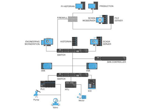

Industrial network security
Security in today’s industrial networks is typically premised on isolation from a corporate network by firewall and from the Internet. Broader attempts to secure industrial networks often entail network downtime, costly network topology changes or both, jeopardizing plant productivity, revenue and sometimes safety. But assuming that a given industrial network is protected simply because we believe it isolated from the Internet is a misconception.
As recent cyber attacks have illustrated, the reality is that isolating a modern industrial network from the Internet can actually make it less secure, since it’s harder to manage and diagnose issues. Isolated networks are also difficult to scale and reconfigure as companies update supply chains, adopt new technologies or evolve in response to new competitive threats and opportunities.
IIoT network security must take a multi-layered approach to protect the data plane, management (network and element) and control (protocol) planes. All three require protection, particularly for M2M communications. A typical approach relies on encryption of data, management and control traffic, addressing authentication, authorization and accounting (AAA), and data integrity.
Networkwide encryption is another layer that guarantees security of all network traffic. In Ethernet networks, MACsec (IEEE 802.1AE) and Keysec (now part of IEEE 802.1X) are the L2 encryption and key management protocols to secure Ethernet physical ports and VLANs. Further enhancing confidentiality, IEEE 802.1AEbn includes strong 256-bit encryption now required by certain government agencies.
While encryption alone is insufficient to secure a network, using a strong 256-bit encryption like MACsec in networking equipment and end points can provide a means for authentication, data integrity and user confidentiality needed in Ethernet-based IIoT networks. In addition, leveraging FPGAs with built-in security capabilities can be used to provide a root of trust in a system. Often these devices are used to securely boot an external processor, adding yet another security layer to combat against tampering with network elements to find keys.
As IIoT becomes more widespread, companies will increasingly look to acquire data at the network edge, using big data analytics and cloud computing to scale processing and make practical use of all this data. An Internet connection is essential. This is where a centralized security orchestration approach that works closely with distributed networking hardware can provide an effective way to secure the IIoT network.
Ultimately, a multi-layer approach to security is imperative for industrial networks, ensuring the network’s reliability and uptime while not restricting operations.
