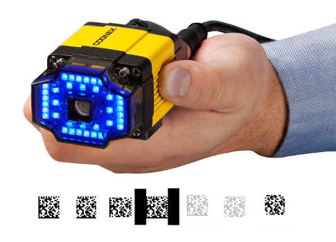

Barcodes
Barcodes were a major step up from manual systems, and with many options and price ranges, even the smallest organization could implement some kind of barcode system. The greatest advantage of a barcode system is that everything tagged has a unique identification number. With 2-dimensional (2-D) tags, it is possible to embed additional information specific to that item (serial number, lot number, production date, etc. ). When the barcode is scanned, the embedded data ties back into a backend systems and other databases to help the manufacturer keep accurate tabs on inventory, improve visibility and create a chain of custody throughout the manufacturing lifecycle.
Obviously, barcodes reduce the need for manual data entry, therefore, increasing productivity and accuracy. The main downside to barcode systems is that they require a line of sight—someone must still aim the scanner at the code, within a certain distance, to obtain a reading.
