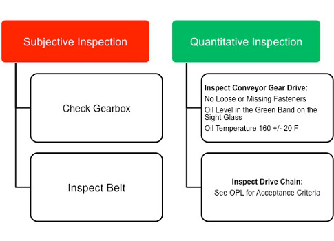

Fundamental belief number 3: The details beneath the task matter.
If we want to predict and control failures, we can no longer afford to send our people out with task descriptions that read like “check the gearbox”. We need to understand that there is a right way and a wrong way to perform any task, and statements like “check the pump” leave way too much to the imagination.
In situations like this, I often get pushback that sounds something like, “You have to understand; every one of our mechanics has been here for more than 30 years, and they know how to inspect a gearbox.”
Here’s a way to test that theory: take 5 of these people with the 30 years of experience and give them each a blank piece of paper. Ask them to jot down a few notes on how they inspect that gearbox. Do you really think that those 5 pieces of paper are going to look anything alike? If they are not identical, then at least 4 of them are performing that inspection at a subpar level (I shy away from the word incorrectly as it comes with so much baggage), and there is a distinct possibility that all 5 of them are performing that inspection at a subpar level.
What is the correct answer? We need to get quantitative with our task descriptions (see the graphic). Once we get quantitative, we have a baseline to build upon. When failures occur in the future, we learn from them, adjust our criteria, and if we are careful enough, we will have eliminated that particular failure. Now on to the next failure and repeat the process. We need to realize that “continuous improvement” of our proactive maintenance program is not some buzzword that we toss around in meetings when we are trying to impress our boss. It must become the core of who we are as an organization. Improving these tasks is a career-long commitment, we never lack for opportunities to learn and improve.
