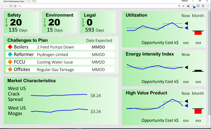

Plant managers making complex decisions daily that impact an organization’s bottom line and asset criticality. It begins with the Key Performance Indicators (KPIs) that define the operating performance of a manufacturing plant – the handful of key levers that ultimately control the business operation and lead financial performance. They can be separated into two clusters. First, the KPIs that express and protect the license to operate, which include safety, environmental, and compliance protections. If those aren’t done successfully, a manufacturer may not be allowed to operate. Figure 1 dashboard shows the critical KPIs for a manufacturing plant.
Figure 1: Dashboard that shows the critical KPIs for a manufacturing plant.
Figure 1: Dashboard that shows the critical KPIs for a manufacturing plant. Courtesy: AspenTech

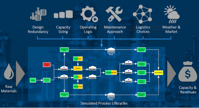

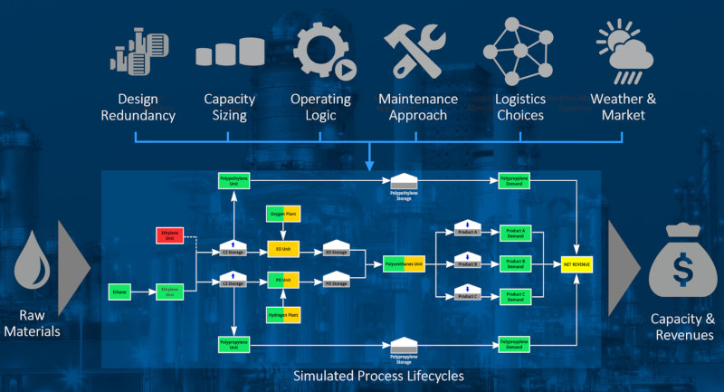

To put it simply, a manufacturing process takes raw material(s) and adds energy, in a regular, ordered process, to manufacture the product(s). However, there are elements that can encourage or constrain the time, efficiency and ultimately the profitability of the process. Decisions on how the process is planned, scheduled, and operated play a major part, and external influences can impart negative consequences. They can be seen in Figure 2, indicating the process steps from raw materials to products in the example of an integrated chemical manufacturing site.
Figure 2: Process steps from raw materials to products for an integrated chemical manufacturing site.
Figure 2: Process steps from raw materials to products for an integrated chemical manufacturing site. Courtesy: AspenTech
The process is designed up front and put in place with certain built-in constraints such as redundancy of equipment, the capacity of equipment / trains / units and of intermediate and final storage. Many items are adjustable, such as the operating logic, plans, scheduling and the approach to maintenance and logistics choices, such as shipping methods. However, some items that affect performance, such as market volatility, weather, logistics and shipping, are not predetermined. All these factors influence the ultimate plant performance and profitability. Some of the most significant factors are about the mechanical equipment and availability to the operating plant. Equipment can fail or wear out, causing interruptions to production. Any time equipment is out for service maintenance, it can mean significant losses in production, which could amount to exponentially more than the cost of the maintenance and repairs.

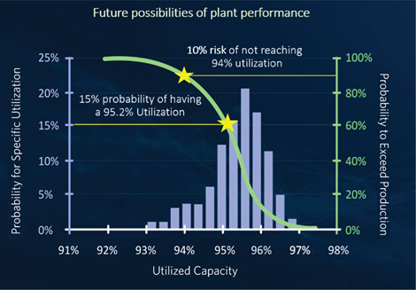

Figure 3: Typical chart from a RAM application indicating probability of performance outcomes that show the likelihood of operating at varying production levels.
Figure 3: Typical chart from a RAM application indicating probability of performance outcomes that show the likelihood of operating at varying production levels. Courtesy: AspenTech
Figure 3 is a typical chart from the RAM application. It indicates probability of performance outcomes that show the likelihood of operating at varying production levels. Figure 4 shows, in ascending order, the items that are most to blame for missing targets at that financial level. It is a clear indication of what’s most likely to happen and shows what’s most important to work on first. Such a result is far more useful than current criticality analysis based on an isolated machine or no mathematical methodology.
