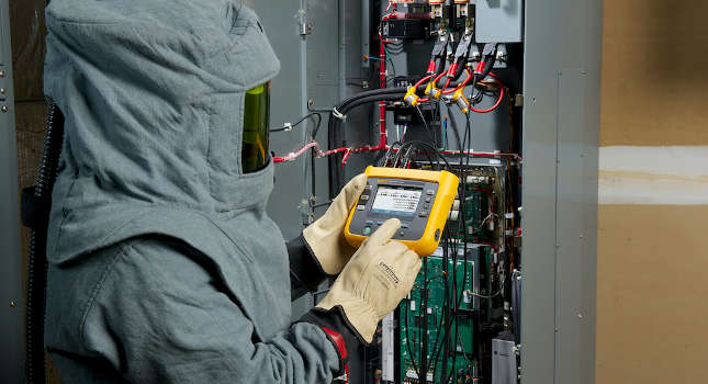

Measure harmonics at the point of common coupling using a power quality analyzer or a harmonics analyzer. For simple snapshots, use a high-quality digital multimeter for harmonic voltage or high-quality clamp meter for harmonic current. The digital multimeter and clamp meter must be true RMS, which is necessary for accurate measurements of distorted waveforms.
True RMS refers to the root-mean-square, or equivalent heating value of a current or voltage wave shape. “True” distinguishes the measurement from those taken by “average responding” meters. Average responding instruments give correct readings for pure sine waves only and will typically read low by as much as 50% when confronted with a distorted current waveform. True-RMS meters give correct readings for any wave shape within the instrument’s crest factor and bandwidth specifications.
