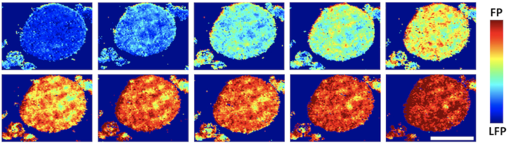

A phase map of an agglomerated particle in a common lithium iron phosphate (LFP) battery electrode shows the charge distribution as it goes from 4% to 86%. FP refers to iron phosphate. Rice University scientists found that the FP phase spreads nonuniformly on an aggregate surface upon charging, rather than the expected even spread of lithium over the surface. The scale bar is 10 microns. Courtesy of the Mesoscale Materials Science Group

In images taken at Brookhaven’s powerful X-ray synchrotron, the researchers saw some regions inside the cathode were better at absorption than others. The ability to look at single or aggregated particles in 3D showed that rather than reacting over their entire surfaces, lithium favored particular regions over others.
“This is very different from conventional wisdom,” Tang said. “The most interesting observation is that these reaction regions are shaped like one-dimensional filaments lying across the surface of these aggregated particles. It was kind of weird, but it matched what we saw in our models.”
He said stress between misaligned crystallites in the particle agglomerates prevents lithium from being uniformly inserted into or extracted from the aggregate surface because that will generate too large an energy penalty. Instead, lithium is forced to flow into or out of the aggregates at “hot spots” that develop the filament shape.
