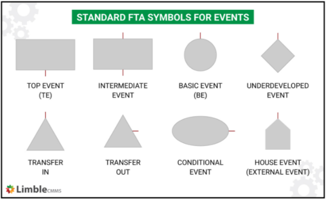

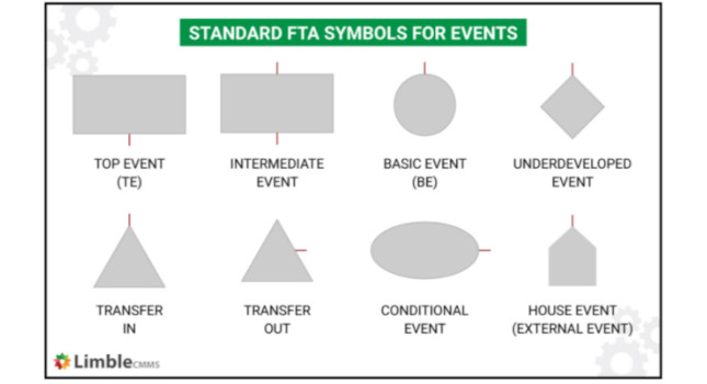

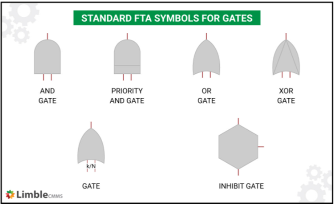

These symbols are used in fault tree analysis (FTA) diagrams.
These symbols are used in fault tree analysis (FTA) diagrams. Courtesy: Limble
