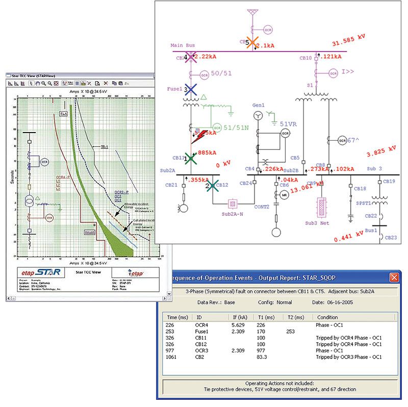

Figure 2: Screen captures of ETAP Predictive Stimulation Analysis information shows sequences of operations and time current curves, among other things. Courtesy: Schneider Electric
