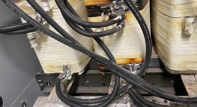

Remember, heat accumulation can degrade and lead to the failure of the transformer. In Figure 2, this point of degradation and failure at a connection point is very clear. The heat accumulation at the connection point far exceeded the 428°F temperature rating of the insulation system, causing insulation burning and transformer failure. The burned connection points in Figure 2 are one of the three transformer primary winding taps. The position of the taps can be arranged during the installation to best match the incoming power supply voltage.
Considering the nameplate of Figure 1, the primary voltage of 480 volts will pull from the incoming power supply 90.2 FLA per phase, much less than the secondary windings. Nevertheless, considering the same terminal resistance of 0.001 ohms, the resulting power will be 8 watts, much lower than the secondary, but still consuming power and generating heat.
Given that Figure 2 shows the primary taps, this connection must have been much higher than 0.001 ohms, perhaps in the several ohm range. For example, if the connection point resistance was 0.2 ohms, the resulting power dissipation would have been 1,627 watts — much hotter, which may have caused this burning and the insulation system failure.
