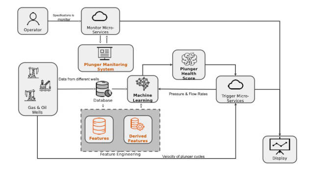

AI-assisted automated plunger lift
An AI-assisted plunger lift system is designed to optimize the performance of plunger lift operation while reducing emissions and improving efficiency. The system is powered by advanced AI algorithms that analyze raw and derived features such as instantaneous casing and tubing pressures, flow rates and liquid load to make predictions and provide recommendations. This includes predicting plunger velocities, forecasting gas production rates and optimizing the duration of shut-in and after-flow phases through triggers.
One of the key features of the system is its ability to fine-tune the shut-in end trigger to only activate within a specific range of velocities. This ensures that the plunger lift system is operating within safe limits, minimizing equipment wear and tear and maximizing gas production rates. In addition, the system can optimize the duration of the after-flow phase to maximize gas production and minimize the frequency of shut-ins. This helps to reduce the probability of nonarrivals, which can lead to the venting of natural gasses into the atmosphere.
It also includes a user interface for real-time data monitoring, allowing operators to track key performance metrics and other relevant data in real time. This includes data on plunger lift speed and pressure, fluid flow rates and temperature, among others. It also has model training capabilities, allowing it to learn from data and improve its performance over time. This could involve using machine learning algorithms to automatically detect patterns and trends in the data and make predictions about future behavior.
Figure 4: Flow diagram of artificial intelligence-assisted plunger lift system. Courtesy: Qult Technologies
This system is designed to provide operators with the tools and insights they need to optimize plunger lift operations, reduce emissions and improve efficiency. It is flexible and adaptable, able to work with different plunger lift systems and changing conditions and to optimize plunger lift operations in real time.
