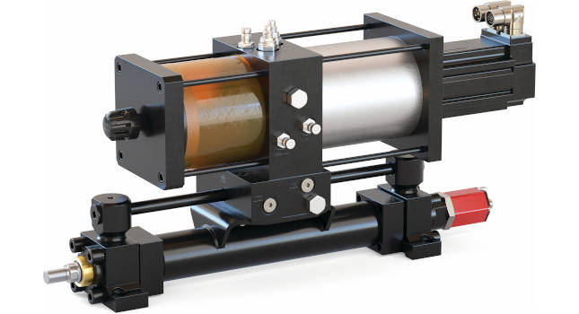

Actuated valves are critical for high-pressure fluid service where precise flow control and process autonomy are necessary. Automating valve operation improves the quality of fluid flow applications since the valves open or close at predetermined intervals, and enable process engineers to remotely control processes.
In industrial environments, engineers handle different high-pressure pipeline applications. These vary from chemical processing, oil and gas to water/wastewater systems.
The high pressure in the piping system has several effects on the hardware and flow control mechanisms within the pipeline. It stresses pipe connections and internal pipe walls, strains pumps and impacts the corrosion of valves if the service media is viscous. Selecting actuated valves for such environments requires careful evaluation of the flow conditions as well as a proper valve sizing.
There are many types and sizes of valves high-pressure fluid applications. Engineers also can choose from diverse valve actuation technologies to facilitate optimum pipeline performances depending on the desired flow control characteristics. An actuator can control process valves through rotary motion (rotary actuator) or linear motion (linear actuator).
Energizing the actuator causes the valve to start/stop the flow of fluids or throttle fluid flow where necessary. Actuators require an external power source to operate. A manually-operated valve contains a lever handle or handwheel that connects to the valve stem or to a gearing system, and delivers sufficient output torque to manipulate the position of the valve mechanism.

The actuator is responsible for moving the valve to appropriate positions depending on the pressure conditions or control signals of the pipeline, as well as for holding it in place. The actuator provides the right operation speed for valves to maintain the consistency of fluid service in applications. Each of the actuation methods has its pros and cons: for example, a pneumatic actuator can provide dependable and durable valve operation for high cycle speed piping systems.
