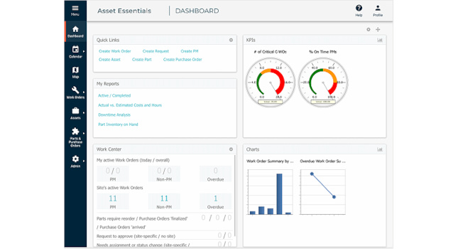

Benefits of using CMMS software to build a maintenance plan
A computerized maintenance management system (CMMS) consists of a central repository of all maintenance data. That includes information about each critical asset, machine, equipment and device within the organization.
Apart from this, a CMMS allows maintenance managers to monitor the data in real-time while using historical data to analyze and improve their maintenance effort. Optimizing inventory and procurement systems are additional benefits from using CMMS software. It also includes features that managers can use to schedule maintenance activities, order supplies, issue requests and prepare reports.
