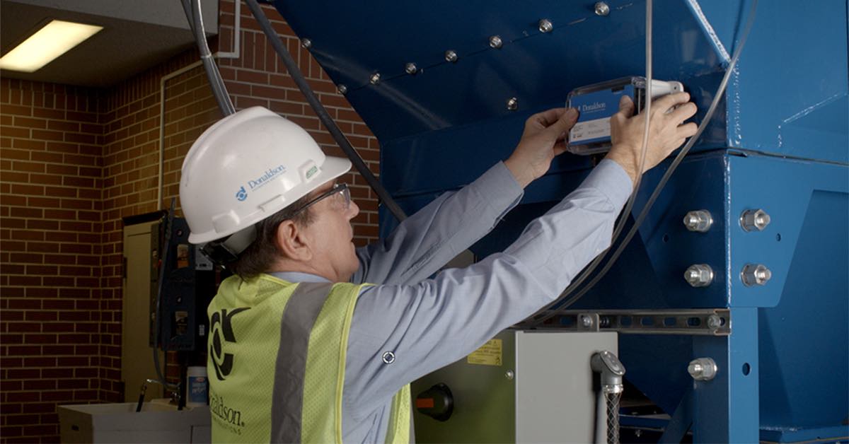

The installation process for dust collection equipment monitoring through Donaldson is simple, using several standard sensors integrated into a cellular gateway. Courtesy: Donaldson
