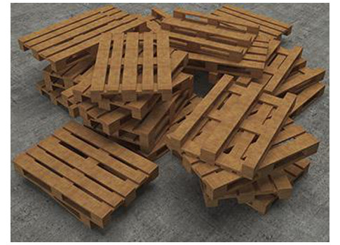

"There are certain fixed aspects of distribution logistics – the size of airplane cargo holds, ocean containers, trucks on different continents, pallets on different continents – and yet many companies fail to take full advantage of these various fixed spaces. For instance, standard U.S. pallets are 48" x 40", which fit well into U.S. trucks that are 101 in wide and 53 ft long, but they leave significant empty space in standard 40 ft ocean containers and air cargo cookie sheets.
These differences are the nitty-gritty of packing engineering, and it’s easy to see what happens when product designers are unaware of end shipping modes, or packaging design is not represented in the development cycle.
Uncovering waste in the process
"Many U.S. pallets are simply disposed of once they reach Europe, where products are then transferred onto standard reusable pallets measuring 1200 x 1000 (47.25" x 39.4") or 1200 x 800," warned Howard. "If the U.S. package fits perfectly onto the U.S. pallet, it will have overhang in Europe, resulting in some amount of crushing damage to the bottom boxes. U.S. pallets simply do an awful job of fitting onto air cargo cookie sheets, so freight forwarders remove products from expensive pallets and simply hand stack lots of boxes into the void spaces, thus guaranteeing excess handling that inevitably increases damage rates.

2. Get the wood out. Consider replacing wood pallets with slip sheets for international shipments. Wood is expensive, heavy, causes worker injuries, can cause box damages, introduces tremendous amounts of moisture into enclosed ocean containers and takes up valuable space that would be better used by products. In contrast, slip sheets are no more than 0.25 inches thick, can be made in any footprint size that can better use floor space than pallets; slip sheets can be made with 100 percent recycled material and can be recycled again after use (unlike pallets).
