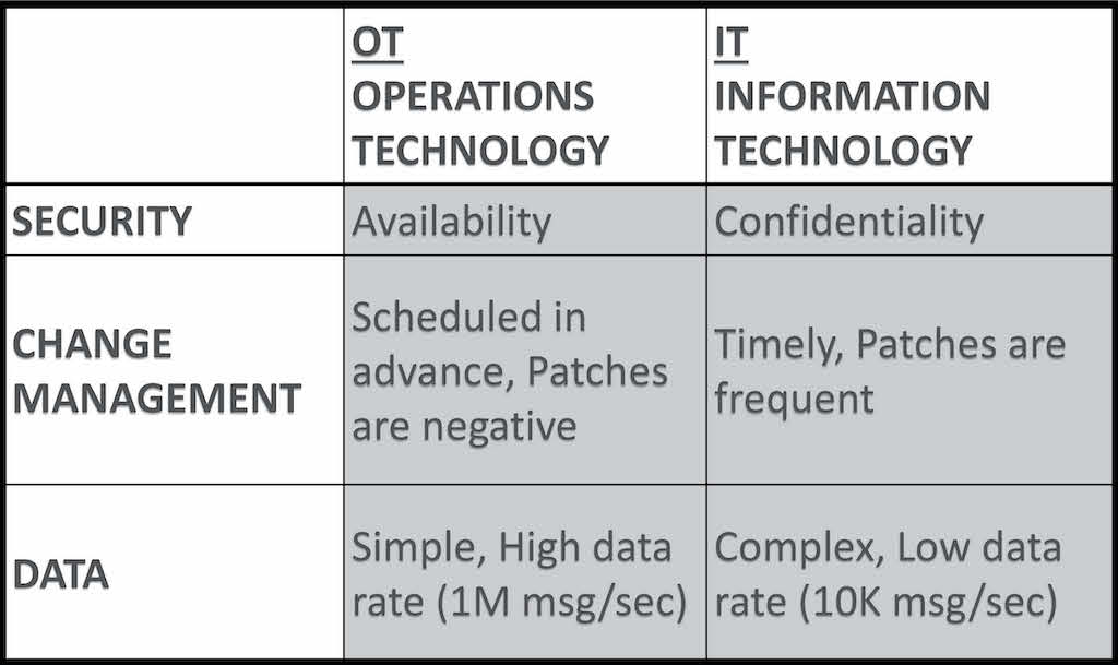

Priorities of OT and IT Network Professionals. Courtesy: elliTek
IT/OT philosophical distinctions
IT’s goal is ensuring the security of every IT-based asset, which requires constant updates to security systems and associated infrastructure, and OT’s goal is to maintain a constant process with limited variability to maximize production.
Are you realizing the dichotomy? One requires constant change and the other mandates sameness (see Table 1). The tragedy is this difference often has been used by IoT product suppliers to describe the “issue” preventing convergence. This is the point where the savvy and wise manufacturer avoids falling prey to this erroneously marketed definition of the IT/OT convergence problem.
Despite IT and OT’s glaring philosophical difference, each is fundamentally correct and equally important. The act of forcing compromise undermines the reason for each group. Consider this: What plant manager would think it wise to ask IT to overlook stringent cybersecurity practices to further the needs of production or support needs of maintenance? Conversely, what IT manager would insist production endure hours of downtime to allow IT to perform security updates on plant floor PCs as often as they deem necessary? Unfortunately, these sorts of ill-gotten decisions are often unknowingly made, which is where the actual tragedy occurs.

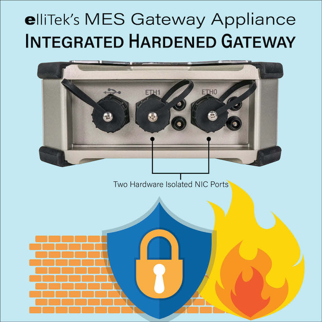

elliTek's IIoTA MES Gateway Appliance. Courtesy: elliTek
elliTek’s IIoTA MES Gateway Appliance. Courtesy: elliTek

If cybersecurity countermeasures are not a top priority for the plant, perhaps a cellular-based cloud connection is acceptable. Go ahead, converge your OT and IT networks. On the other hand, if cybersecurity is a concern, elliTek’s stance, while disruptive, has proven to be sound: Avoid forcibly converging IT and OT; separate them with a hardened gateway strategy.
