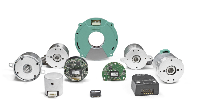

Kit encoders with magnet absolute encoders
Magnetic absolute encoders for stepper motors are available as “kit” or modular devices, designed to be integrated into a motor housing, measuring the rotary position directly from the drive shaft. The core element of these devices is a magnetic measurement module that is compact (as small as 22 mm diameter) and resistant to dust, moisture, and shock/vibration loading. Absolute magnetic encoders can deliver accuracies as high as ± 0.1°, over an operating temperature range of -40 to 105°C.  Multi-turn variants can be useful when a motor is connected to a screw shaft, cable drum or gear reduction system. The multi-turn rotation counter is self-powered, using an efficient, maintenance-free energy harvesting system based on the Wiegand effect, where a magnetic field in specially designed wire flips when exposed to a magnet, creating voltage. This eliminates the need for backup batteries.
Kit packages are available with the same mounting form factor as popular incremental encoders for NEMA-standard stepper motors, making these encoders convenient drop-in replacements for less advanced incremental encoders.
Since kit encoders do not have the housings, shafts, bearings or seals required for self-contained encoders, manufacturers can deliver the core measurement module at relatively low prices. As a result, stepper motor-encoder combinations are often less expensive than comparable servomotors. Cost efficiency also extends to the steps required to install magnetic kit encoders in a stepper motor’s housing. The magnetic measurement technology is relatively tolerant to minor misalignment between the rotating element (a small permanent magnet fastened to the motor shaft) and the components bolted to the housing. This simplifies assembly procedures and reduces manufacturing costs. A self-calibrating feature can compensate for minor alignment errors without loss of measurement accuracy.
