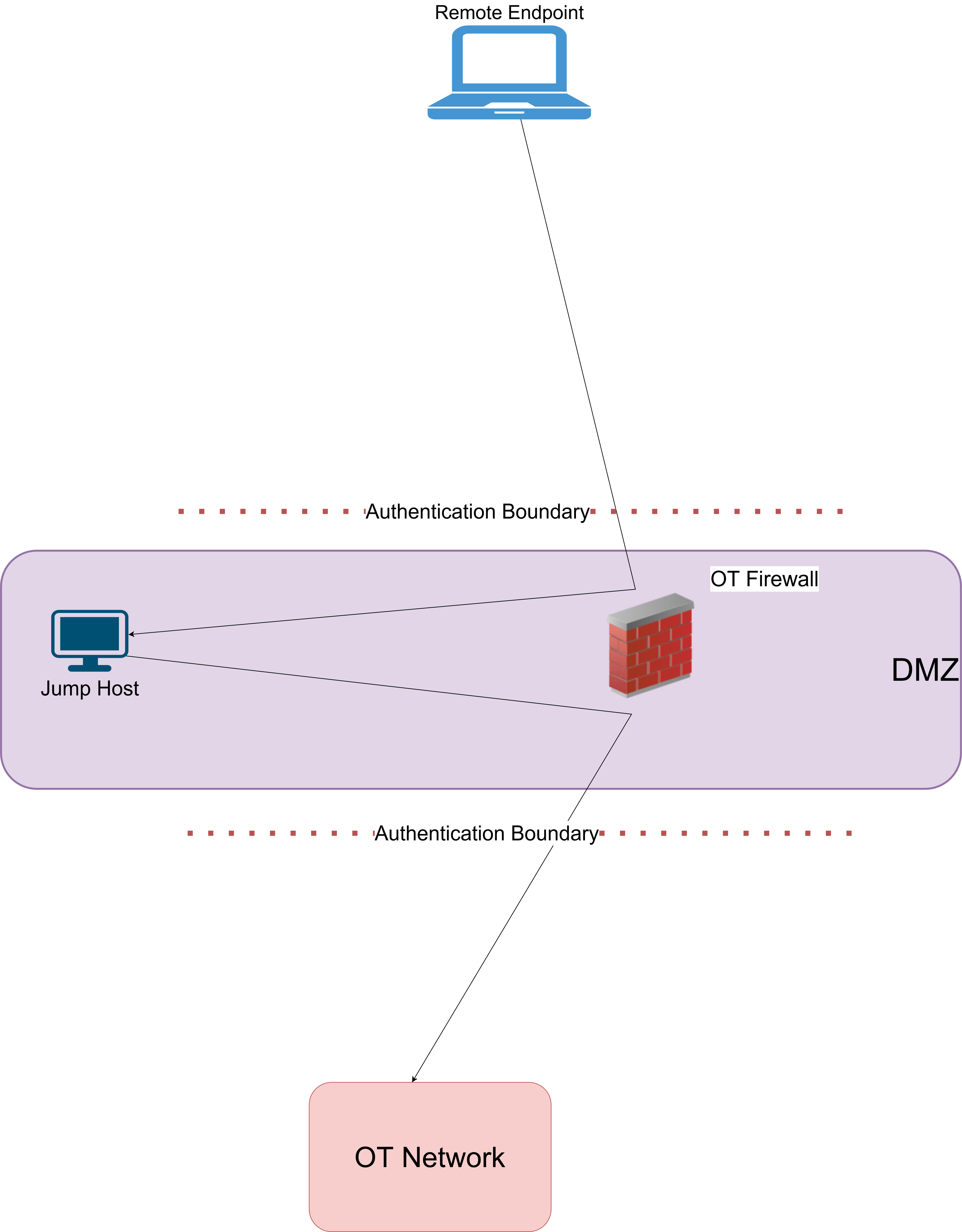

Separating IT, OT networks with a DMZ
Isolation of critical infrastructure from the IT network’s general traffic is a crucial first step in network security as it limits a cyber-attack from traversing into the OT network. This practice is typically achieved with a firewall at the edge of the IT network and another at the edge of the OT network. The two firewalls control traffic entering and exiting the networks and enforce security policies limiting only necessary traffic.
The jump host controls entry to the OT network. A user accessing the OT network must first connect to the jump host, which only allows those authenticated and authorized to do so. Courtesy: E Tech Group
This arrangement creates a buffer area between the firewalls, commonly known as the iDMZ. The iDMZ may host devices that require interaction with both networks, including data historians, data logging servers, and various gateways. In figure 1, which shows a typical industrial network layout, the iDMZ is shown at level 3.5, indicating it doesn’t belong to the IT or OT network.

Have a singular entry point to the OT network
To access a device on the OT network, a user first connects to the IT network, and then connects to a jump host prior to traversing into the OT network through the iDMZ. This strategy minimizes the points of entry to one, and this path can be carefully controlled. A jump host (secure computer) connection requires any user accessing the OT network must first connect to it and only those authenticated and authorized are able to do so.
The jump host serves a complementary role to the OT domain controller for network security. Together, entry into the OT network is controlled by the jump host, while the domain controller manages allowed behaviors within it.
