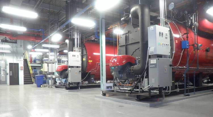

You know that your boiler is a major energy user, and you may have concerns about its efficiency. But if boilers are the right size and type for their operations, some owners are reluctant to replace them. The efficiency problem may not be the boiler itself, but the burner. Owners are discovering that they can make major improvements in operating efficiency by installing a replacement burner, with improved turndown, higher combustion efficiency, lower emissions, and precise control capability.

In a recent presentation at a Technology & Market Assessment Forum (TMAF) sponsored by the Energy Solutions Center, Hikmet Demiryol from Weishaupt Corporation discussed potential benefits of replacing older burners on boilers, taking advantage of advanced technologies. Weishaupt is a global provider of boiler burners, both as original equipment and for retrofit installations. Demiryol pointed out that the thermodynamic properties of many older boilers are still very acceptable.
He noted that a well-maintained boiler has a long life – as long as 40 years. He stated that there have not been major changes in the design of the heat exchanger in the boiler in 60 years. However, replacing the original burner with a high-efficiency modern system can result in fuel savings ranging from 5% to 40%. Demiryol said that current Weishaupt burners significantly reduce excess air at all firing rates. Lower excess air means higher combustion efficiency.

A key to burner efficiency is strict regulation of the amount of excess air for combustion at all operating levels. Today’s burners – both gas-only and gas/oil – are designed to minimize energy-wasting excess air. By holding excess air levels to 4% or less, boiler efficiency is significantly improved. Many modern gas burners can hold these levels through the full turndown range. The key to excess air control is a precise damper mechanism for combustion air that maintains accurate and low excess air levels through the entire range.

He indicates that an option that is frequently being chosen is an oxygen trim control that senses O2 levels in the exhaust gas and adjusts combustion air accordingly. “We use O­2 trim on units above 200 hp, as this is the area where the added expense will show benefits in terms of payback.” He notes, “O2 trim is really only useful if there are large swings in the combustion air conditions in the boiler room, variations in the fuel Btu ratings, and/or the boiler breeching has uncontrolled swings in draft.”
In any case, McDonald says, Riello burners are capable of running between 3.5% and 4.5% excess air. “This is because the mechanical cam versions of our standard burners are precisely machined and have turnbuckle-type connections so there is very little or no free play in the linkages.”
