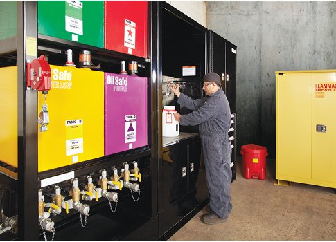

Maintenance managers are using modern, single-solution bulk storage systems that centrally store, label, transfer, and dispense lubricants easily, efficiently, and accurately. There are three key factors that make bulk storage system a better choice.
Visually intuitive
Drum labels can be hard to read. The variation across lubrication brand labels often makes it difficult to locate critical data such as fluid name, viscosity, manufacturer, date code, equipment application, and so on. Labels fade easily, can be damaged, or can fall off thus rendering the drum unreadable. This can leads to the wrong oil ending up in the wrong application. Without clear visual identification, the overall risk of mistakes and safety hazards dramatically increases, which can lead to costly, dangerous, and potentially devastating errors.
In bulk storage systems, the color-coded system makes the lubrication management process more visually intuitive, eliminating the guesswork from the maintenance process, as well as the potential for cross-contamination. The labels are easy to read and consistently placed and protected. This helps ensure the right lubricant goes to the right place at the right time. A visual identification system also is a critical step in 5S and Poka-yoke lean concepts.

Bulk storage systems act as a centralized hub for the proper storage, transfer, and dispensing of lubricants, which promotes accurate and reliable fluid transfer. A modular, stackable design makes bulk systems more compliant with cleanliness and reliability.
Bulk storage systems are self-contained and allow for safer fluid transfer, which eliminates the risk of environmental contaminants and cross-contamination. Systemized processes clearly communicate lubricant information and application, which removes the risk of contamination often seen in unorganized, compromised 55-gal drums. With a bulk storage system, your facility sees the unparalleled benefit of a more organized, cleaner lubrication process.

Conversely, bulk storage systems eliminate the risk of safety hazards; the units are the only clean, safe, and ergonomic way to store and dispense lubricants. Bulk storage systems reduce the risk of worker injury caused by moving and stacking drums, and they promote ergonomic storing and dispensing. Lubrication technicians can easily manage the ins and outs of fluids with all lubricants stored in one organized and streamlined central hub for fast, efficient, and safe transfer and storage.
Standardized bulk systems have labeled dispensers and a large spill pallet that traps any leaks or spills, helping reduce drippings and downtime. The nature of the centralized bulk system simply eliminates the safety hazard caused by tipping and insufficient spill capacity, promoting a safer lubrication process. The safety and reliability offered by the bulk storage system solution is unseen in lubrication processes using 55-gal drums.
