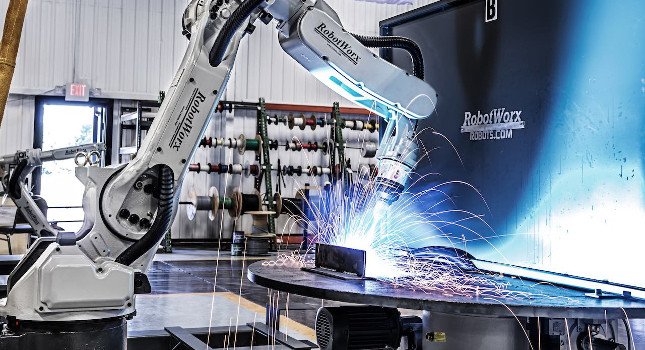

RobotWorx rents robots by the week, month or year. A week is the minimum, but there’s no long-term commitment required. A rental includes a robot, the robot controller, teach pendant and end-of-arm tooling (EOAT). They also rent ready-to-ship robot cells for welding or material handling. The most popular systems are the RWZero (pictured) and RW950 cells.
“The RWZero cell is very basic,” Fischer said. “You have a widget, and you need 5,000 of them. Rent this cell and you have a production line instantly.”
The RW950 is more portable. Fischer called it a “pallet platform.” The robot, controller, operator station and workpiece positioner share a common base, which is a large steel structure that can be moved with a forklift.
“We’ve done a lot of the small weld cells,” Fischer said. “We always have a couple on hand so we can supply those on demand. We’ve done larger material handling cells, as well. We have a third-party company that does the financing if you need it. A lot of people just end up paying it upfront. If they were to purchase the robot after they’ve rented it, we apply that towards the purchase.”
Fischer said 20% of the rental price is credited to the purchase if a customer decides to keep the robot. All the robots and robotic cells are up to date on maintenance before they leave the RobotWorx floor and shouldn’t require any major maintenance for at least a year. He said most customers end up buying the robot if their rental period exceeds a year.
