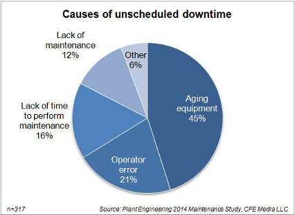

The greatest challenge to overcoming unscheduled downtime is not maintenance, but aging equipment. The study found 45% of respondents said equipment age was the leading cause of unscheduled downtime, while 21% cited operator error. Another 16% said the lack of time to complete maintenance was the key factor, while a lack of overall maintenance was cited by just 12%.
