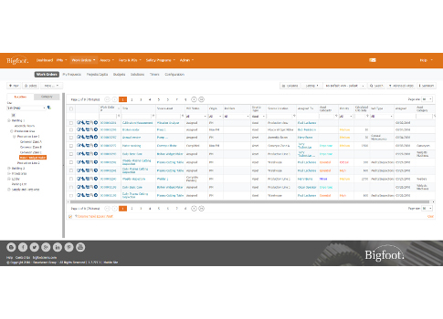

The difference is that CMMS focused on the square footage and facility aspect of a plant can lack the asset hierarchies and location-based structures that an asset-centric CMMS will have, particularly one specializing in the manufacturing industry. CMMS geared towards asset-intensive manufacturers can excel in offering facility maintenance capabilities, but its concentration lies in improving the capacity of organizations through better utilization of an organization’s assets and resources. CMMS that is geared towards manufacturing and other asset-intensive industries can offer work orders based on location as well as category, with an infinite hierarchical structure.
Reactive maintenance and CMMS
Well-designed CMMS can enable plants to properly manage reactive efforts. CMMS with native mobile apps, for instance, offer a simple way to input maintenance requests, and view work statuses. Note that "mobile-capable" CMMS, in which screens are merely optimized for smaller devices, fall short of providing a similar type of solution because these systems can’t offer pinch-and-zoom, swiping, and other inherent mobile features.
