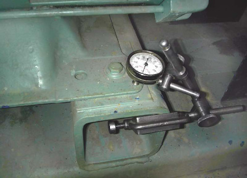

While this procedure of using shaft-mounted alignment indicators may detect the presence of a soft foot with reasonable accuracy, it should not be used when attempting to correct the condition. Rather, manual testing with a dial test indicator mounted at each foot provides a much more effective and efficient means of correcting soft foot (see Figure 3).
With all four bolts tight, the dial test indicator is mounted to the foundation and set to indicate upward movement of the foot as one foot bolt is loosened. An upward movement of more than 0.002-in. (0.05 mm) indicates a soft foot condition that should be corrected. The foot bolt is then re-tightened, and the test is repeated for each remaining foot bolt.
